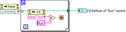

I was hoping to be able to get a control reference datatype from just the control/indicator label name. Attached is an image that shows I am able to get the current value of a control by inputting the control name, but I want the control reference so I can change properties of the said control/indicator.

You can get a property node for the pane and get the "controls[]" property, which is an array of all control references. Now iterate over it using an autoindexing FOR loop and check the label for each. The one resulting in the correct label is the reference you want. (you might need to cast it to more specific later).
