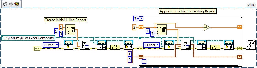

Three replies ago, I told you (in words) exactly how to do this.  Here, in Shiny LabVIEW Functions (and one of my own, called "Wait 2 seconds" that I leave for you to figure out how to create) is a demo that does the following:
  • Creates a new Excel Report with a single line having the number "1" in three columns, waiting two seconds before closing the Excel Report so you can "see" the results.
  • It then enters an "Append" loop to append three additional lines using as close to the same code as the "Create 1-line Report" section as possible.  Differences include:
    • Opening the Report with the existing .xlsx file as the Template file.
    • Via the top Shift Register, creating lines "2, 2, 2", then "3, 3, 3", then "4, 4, 4".
    • Via the bottom Shift Register, putting the first "new" row in Row 2 (the index for row 2 is 1, similar to Array indices) and saying that the "next" row will be the bottom-left edge of the existing Sheet.
I hope you consider accepting this Reply as a Solution so that other Forum users with a similar question will be able to find this example easily.
