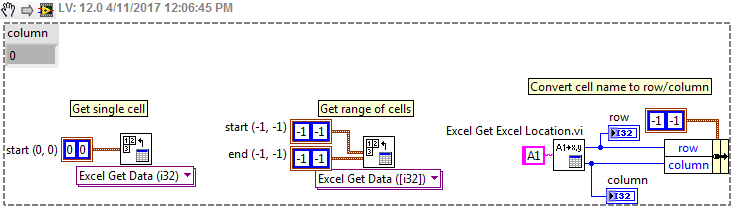

Have you tried using the "Excel Get Worksheet.vi" or the "Excel Get Data.vi"?  "Excel Get Worksheet" just needs a sheet number or name.  Right click on "Excel Get Data" and select the type of data you want to return (single cell or a range of cells) and then give the range start and range stop as a cluster (row, column).  The best way to learn to use these functions is to try them out, not wait for someone to write your code for you.

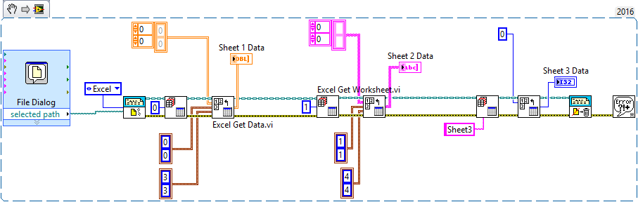

And here is an example how to use "Excel get worksheet" and "Excel get data"
https://forums.ni.com/t5/Example-Programs/Reading-Excel-Data-Programmatically-Using-the-Report-Gener...

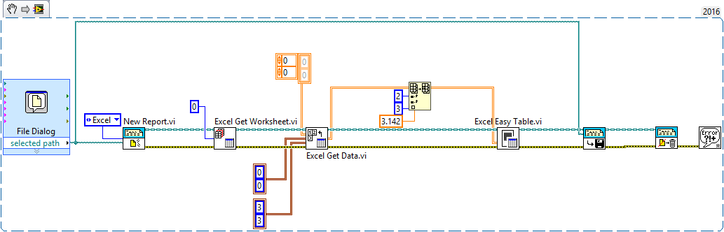

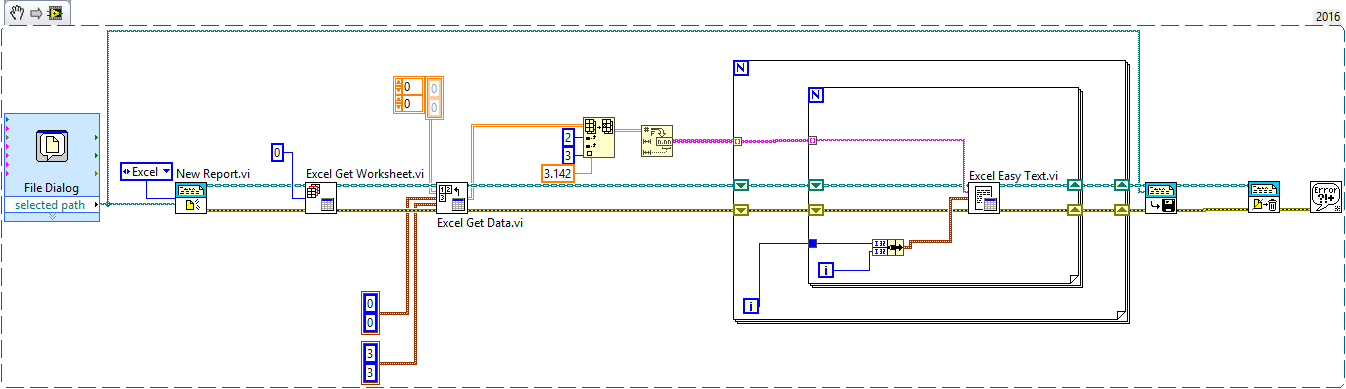

I tried:
And here  is the result
I changed the color of 5 and 6, before running the program and this is unchanged.
BUT the cellcolor is changed from nothing to white and while running the program.
That is not what I wanted 😞
Message 19 of 25
(4,398 Views)
If you open up the block diagram for Excel Easy Text, there is a VI in there called Excel Set Cell Color and Border.  This is found in the Excel Format palette.  I don't know why NI chose to add this formatting and not expose the settings as an input but they did.  The choices you have are:
  • add this Excel Set Cell Color and Border into your program to change the colors back to default.
  • modify the Excel Easy Text to remove the cell format VI.  Keep in mind that if you choose this option, there is the possibility that it will revert back at some point if you install an update or repair an installation.
  • a third option would be to create a copy of the Excel Easy Text, give it a new name, and remove the format VI.
