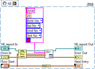

One thing we do want to change is the appearance of the "Active" row.  We do this by applying formatting to change the numbers in that row from Black to Red (so the Experimenter know which row is being used).  Here's the code to do that:
[We run an analogous routine to turn it back to Black].  There is a little ActiveX "magic" hidden in the Row Limits function, which takes the start of the row and returns the start and end of the row.  You should be able to guess what Row++ does ...

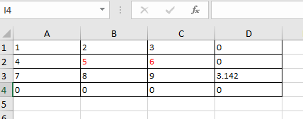

I thing the format changes. The backgrund color of the cells is made white and border lines i put in:

Now I succeeded removing border and background color.
When setting font it’s possible to set it unchanged.
I would have been nice to have the same opportunity with border and background color.

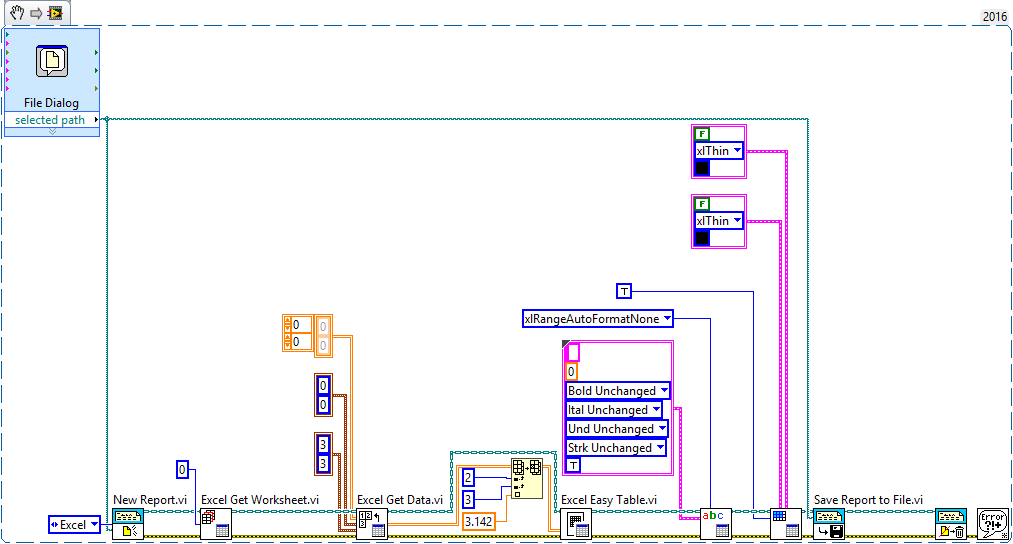

I made this VI, which allows you to open an Excel workbook, and load each sheet into a separate table.
You can edit the table (sheets) and in the end save the workbook.
