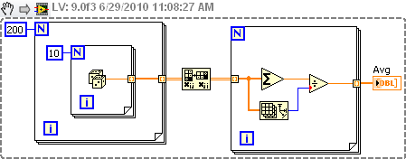

Add all data points and divide by the number of data points.  This is simple arithmetic.  To do this, extract the Y data out of the waveform.  The output is an array.  Use the Add Array Elements function and the Array size function.  Divide the sum by the size.  No loop needed.
By average waveform, do you mean the average of the first data point, then the second data point, etc?  You could extract the Y data from the waveform and wire it to the loop border with indexing enabled.  After the loop, transpose the 2D array to make rows into columns.  Now each row has data from the same position in the waveform.  Send this to a loop with indexing on.  Inside the loop, add the array elements, get the size (should be 200 because you are running the big loop 200 times), and divide sum by size.  Wire the output to the loop border with indexing on.  Your final output will be an average of data points.  You can write this array directly to a file using Wrtie To Spreadsheet File.
 17681i0B55CF3E3449E58F
