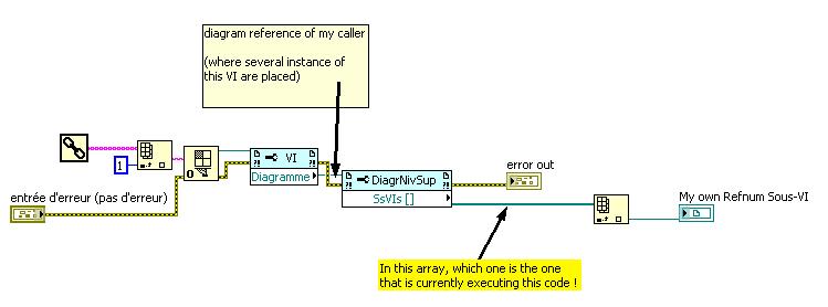

Ok, to be more clear... let's take a look at the following VI diagram.
In this VI code, what I need is to get the reference of the instance subVI (which currently executes the code) from the array containing SubVIs references.

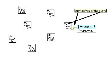

To  give an example, let's take a look at the following diagram. There's several instance of my "famous" VI which should return it's own subVI reference.
Here, I just want one of the instance of my subVI to be "put in evidence" (sorry it's a french LabVIEW that I have).
This is just an illustration of what could be done... once again, my real need is a little bit longer to explain...
