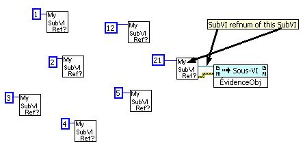

To follow the discussion (by the way, thank you for your interest), with the following code (just add an input to my famous VI), I can achieve what I want. Except that, for some reasons, I don't want to add any input to my SubVI. 😞

I've tried to manage some thing using the property "execution order" or "firing order" (sorry mine is in French so I just imagine the name of the property in english) from the diagram of the VI containing my subVIs, but unfortunately this property gave me back an empty array !!! 😞 😞 😞

Definitively no confusions...
In deed, in 90% of cases I can achieve what I want : getting THE corresponding of THE considered subVI through the array of subVIs references.
I would have prefered 100 %...
Anyway, it seems that getting 100 % is impossible.
It could have been possible using the "Execution Highlight Object" property but unfortunately this property return an empty array when the main VI containing the SubVIs is running... 😞
