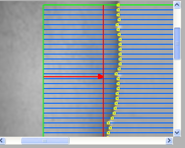

picture 2 is real situation in my program.

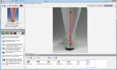

picture 3 is my used sample.

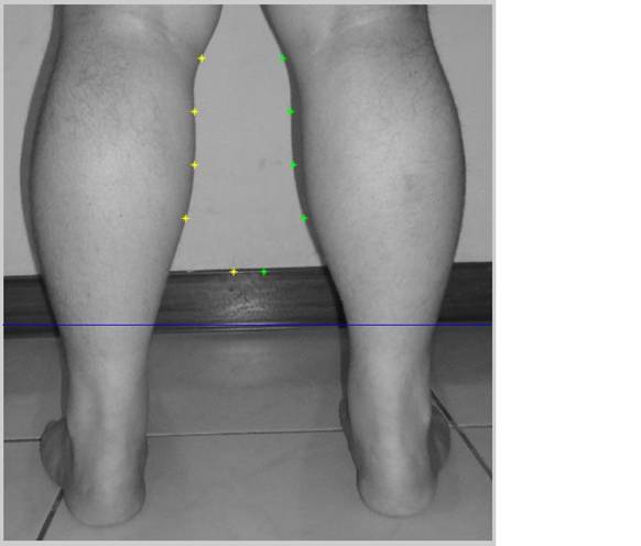

I attached an example and the an assistant script in the zip file.
The results are as follows.
Hope it works for you.
Good luck
