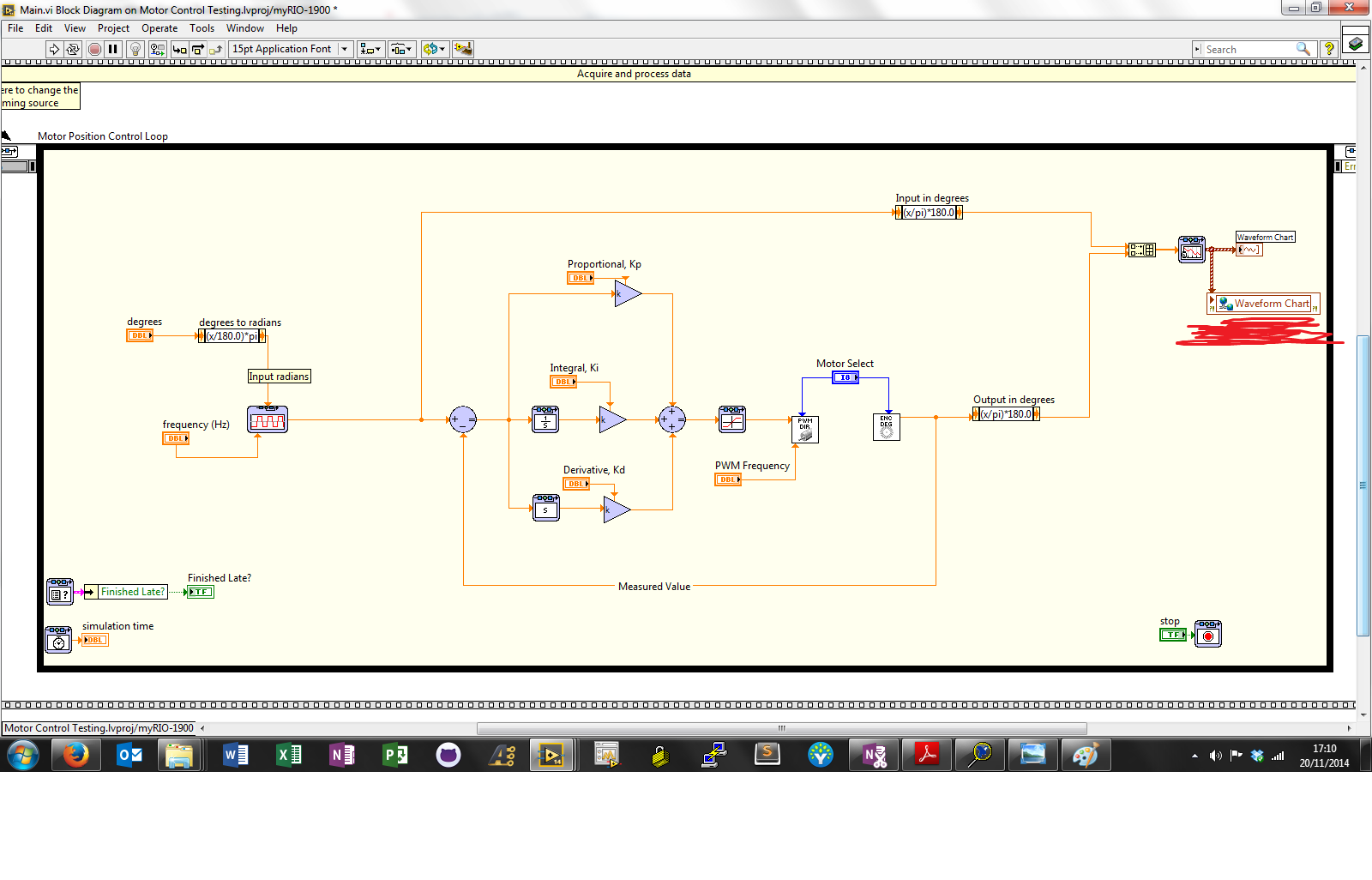

So I have a running PID simulation which is working, I am displaying the setpoint and the step response on a waveform chart (these have history right, I think this is the problem)
I want to send this data off to a data dashboard on my ipad, but the problem is it won't accept a shared network variable of type waveform.
From googling it appears that I will need to create a 2D array network variable with 2 rows, first row is the set point and its values and the 2nd row will be the response.
I tried this but the problem is it is only showing the most current values as I am losing all of the waveform chart history by making a double array. What I need is some way to buffer values maybe 25 or so values and then send them off to the data dashboard so that it gets a little bit of history not just the latest values.
There is no way to put a for loop and create an array of values inside a simulation though.. Please someone help I am really stuck right now.
I've highlighted what I am trying to recreate in red, this shared variable isn't seen by data dashboard though so I need to somehow go down the array with history route. My project is attached.

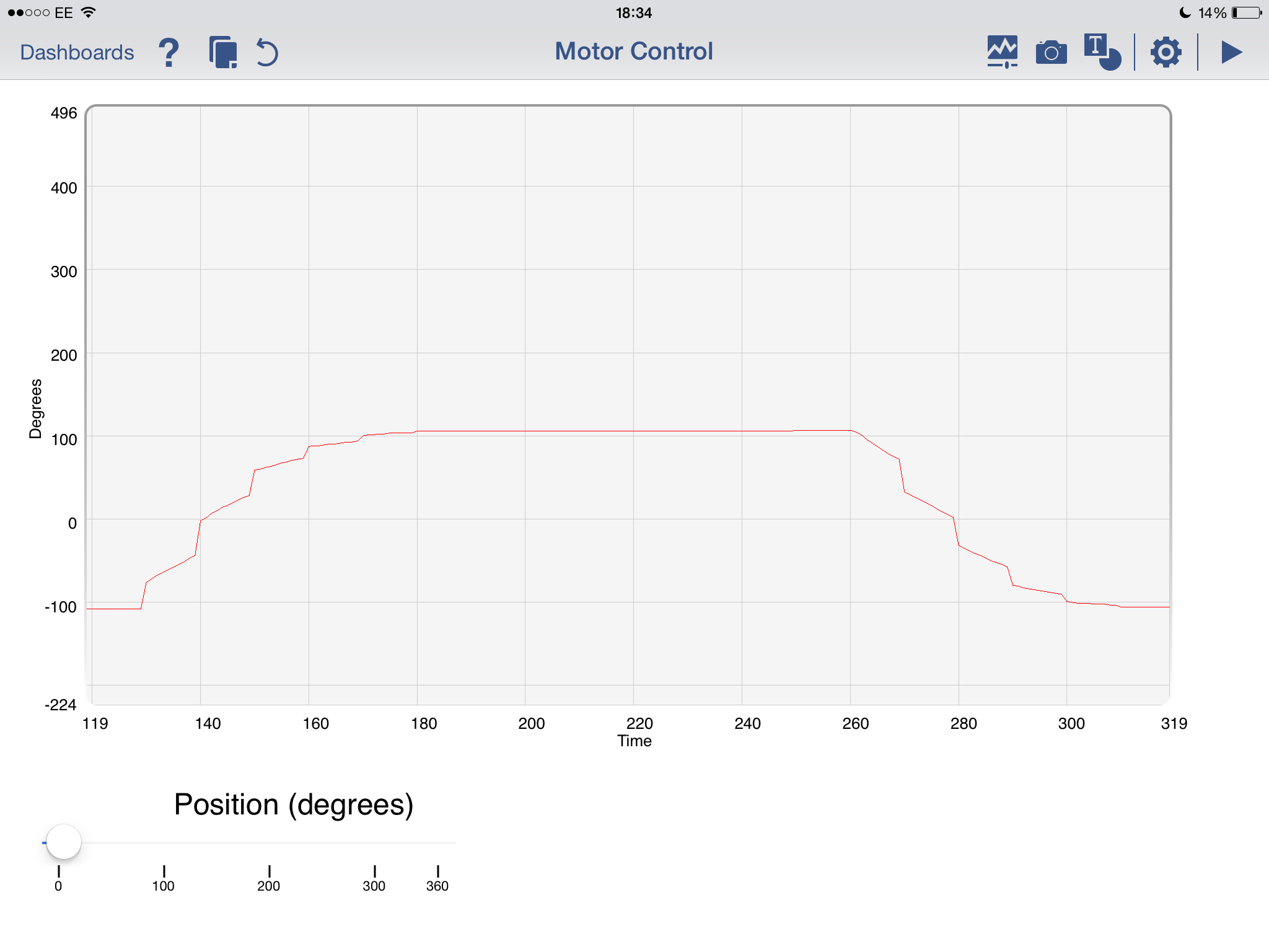

Not going well! Ive tried to buffer the 10 most current values using a queue (I'm sure this is probably the wrong way to do it but I didn't know what else to try)
So now whenever the data dashboard comes it sees an array of 10 values. This is still not working though the data seen from the data dashboard is all garbled. I've given up on the 2D array for now and I just want to get the output channel in a 1D array.

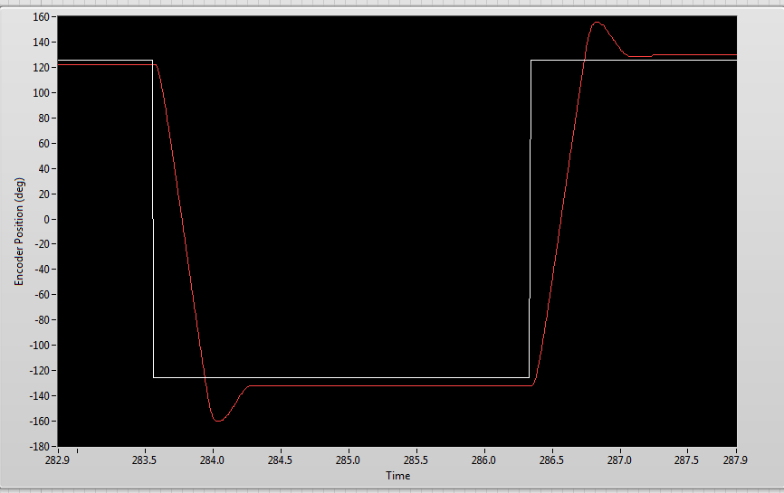

What I want to display is like the graph shown here on a waveform chart on data dashboard. The red line all smooth with no missing points.

What I am getting on Data dashboard looks nothing like that though, Please help there are no examples of waveform charts for data dashboard anywhere in fact the documentation is lacking to say the best. If I increase the buffer past 10 then it goes wild, I need a way to synchronise the data with data dashboard.
