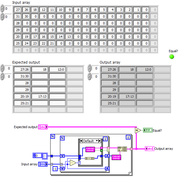

Accepted by topic author curiousguy99
So it seem you want to isolate ranges where the value decrements by one. Here's a very quick draft to get you started.
(For large inputs, I would only keep the max and min in the shift register, so modify if this is needed)
EDIT: slightly improved code can be found a few posts below.

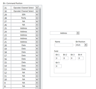

Thanks a lot for your response!!
I noticed how over complicated my code was 😞 . This was a part of code where the each bit ( from 0-31 ) were assigned a bit definition name. I had to get get the position of the bits for the selected bit definition and populate the number of bits accordingly.The 2D array was the bit definition- occurrences array for which I had to calculate the position of the bits. Moreover something like this
