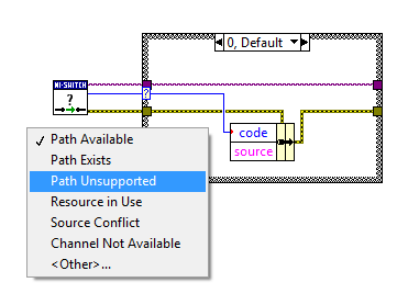

How to get the text of a ring constant?
If I have a ring constant, is it possible to get the context of that ring constant?
For example, I'd like to take the path capability to determine whether connect or not.
If the path is not available, I'd like to handle the error, putting the number of the ring to the code, and the text to the source.
It seemed it is difficult to work out my motivation, any suggestion will be appreciated:)

My question is "Ring Constant", not "Ring Control" or "Ring Indicator".

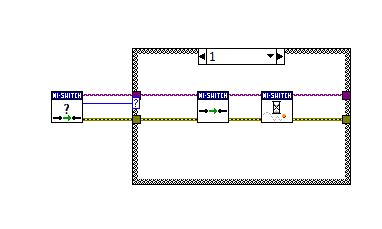

Have you seen my example? I think it is much clearer to look at the uploaded images, and you can ignore my poor EnglishSmiley Mad

For a Ring Constant directly you cannot. You can either create a control for that and use the property "Strings"to get the Item name in String format. Another way is by replacing the Ring Constant with an Enum constant and using the Format into String Primitive.

Hi, P@Anand,
Thanks to your reply, the answer is impossible to get the text from a ring constant.
It's not happy that I can see the text of the ring explicitly on the block diagram but can not get access to the text of the ring constant directly.
