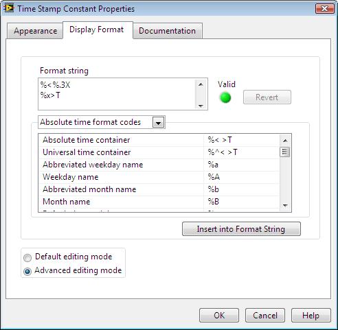

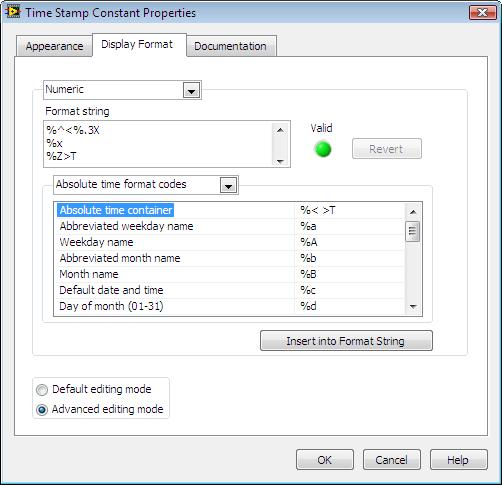

Anyone have any idea why this info was removed from the Time Format Dialog after LV8.5.1 (see below)?
Does this imply that the capability might go away in the future?
It used to be right there, but in LV 8.6 and LV 2009 the selection for "Universal Time Container" is gone.
LV 8.5.1:
LV2009:
