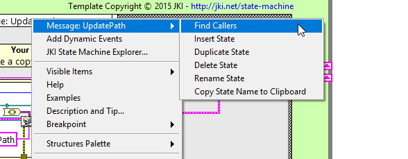

  1. When installed via VIPM additional tools are installed. One tool allows you to right click on a string in a constant or in a case structure and "Find Callers" (see image below) This would allow you to find orphaned states or misspelled states, although going through hundreds of states this can be tedious. But it is useful for debugging.
  2. They are open source. I made some suggestions to their code and they incorporated and improved them.

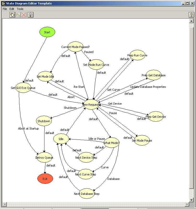

Somewhere the history of LV A Finite State Machine los the word "Finite". "Finite" as in limited number of transitions. While simple application built using a QSM can be controlled and drawn up as a State Transition Diagram, they can grow out of control and before you know it chaos.
The diagram below is one of my busier state machines and was developed back before the Event Structure was trusted (by me) using what is called the State Diagram Editor. I offer as an example how a Finite State Machine can be documented. There are some QSMs that defy documenting the state transitions.
Bad practice?
I will let others deal with absolutes like that.
What I can say is that I have found it extremely useful to include a State Transition Diagram in the block diagram of my code to allow others to be able to understand my or even better remind ME Whiskey Tango Foxtrot did I do?

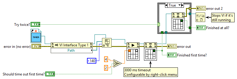

I feel that nobody so far has really answered the question of how to do a "fail-safe" timeout.  When writing your own LabVIEW code you can usually find a way to write it with a timeout that always works.  But if your code has to call code other people write, either in DLLs, library code you can't change, or code written by other devs merged in later, then you can't be certain any of it will work.
Here's a possibility:
If you use a call-and-collect asynchronous call, you can run arbitrary LabVIEW code from within that VI. Then, if it doesn't return within an anticipated time frame, you can either:
1. Wait longer by calling a "collect" again later, but do other code in the meantime
2. Close the reference to the VI, which stops its execution.
The "Collect" node's timeout isn't dynamically settable as you can only set it during edit time, but you can set it to a rather short time and then call the node in a loop N number of times to effectively have a dynamic timeout as long as it's a multiple of the timeout you set during edit time.
This can be a bit dangerous though as not closing the VI reference can lead to having a memory leak, but closing it can stop execution in an unexpected place which might cause other issues.
