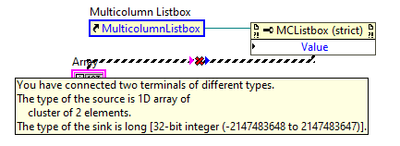

If I create a cluster and make an array out of it I can't seem to either drag the array of cluster into the multilistbox or set the value of MutiColumn ListBox programatically using the following code:

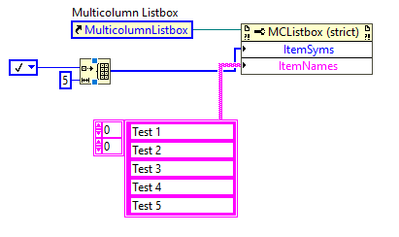

I also managed to make a pretty MultiColumn ListBox but the check mark is just a picture and not a boolean:

I have used listboxes before where clicking (or double-clicking) an entry toggles the check mark symbol to e.g. a blank or an X.
(For example, In this application, I populate entries that have already been analyzed with a check mark symbol. In other applications I would toggle double-clicked entries in grey or even strikeout font to exclude them from global analysis (see picture below). There are plenty of possibilities ;))
The "value" of a listbox is an integer that indicates the selected row. (.. or an array of integers if multiple selections are allowed).
"Clusters" have nothing to do with any of this.
(As you figured out, the item names and symbols need to be set via property nodes.)
