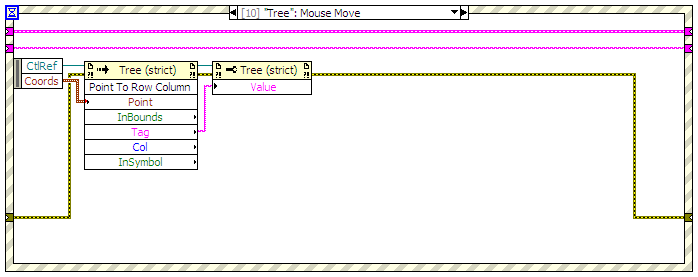

   I would like to highlight a particular cell in a tree when a mouse arrow is moved over it. Similar to wndows drop down menu. Can anybody help me on these.

Jim
(3,361 Views)
Thanks it working !
(3,337 Views)
But I find an issue with this. When there are items with same values in the tree, it always points to the first matched value (even if I set the active item tag to the one where I want to point to). For example, if I have  a tree with values "Hello, Hi, Bye, Hello" and then I set the value to "Hello", it points to the first "Hello" even if I set the tag to the second yellow. Do you know any easy work around for this? Thank you!
