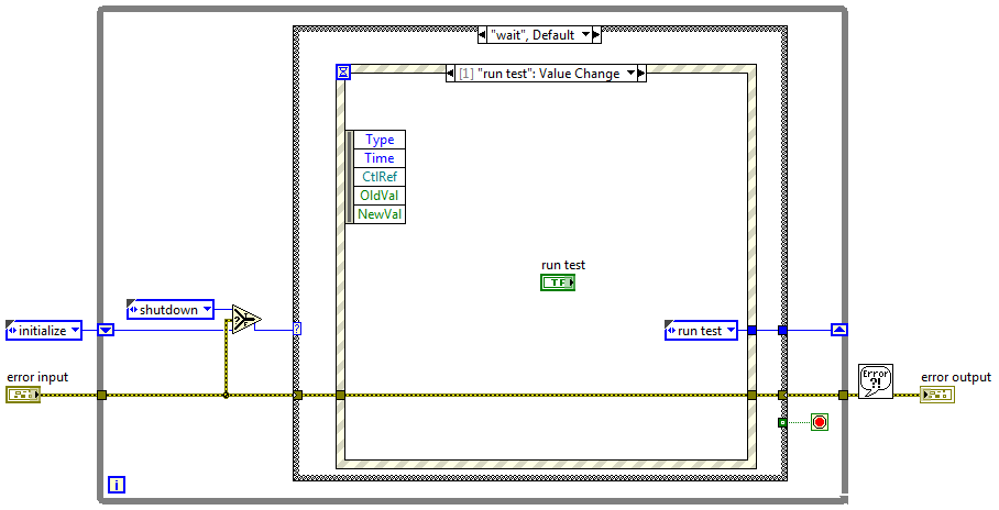

this is not truly an event driven state machine....
  • too many loops
  • data flow dependencies
  • wrong use of boolean controls
  • not a true state machine
here is a template...
Spoiler
