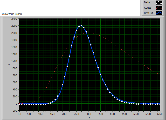

Here's a very rough draft (parameter units are arbitrary for simplicity, so scale accordingly)

The model subVI just calculates the corresponding Y values for all X, given the array of parameters. The error function is here, and you can just drop it in the right place.
The model subVI needs to be strictly typed, so don't delete any controls or indicators that you think you don't need. They all need to be there.
Make sure that the array size of parameter guesses corresponds to the number of parameters used in the model and that the values are somewhat reasonable. I always graph the function based on the initial parameters, just to see if it resembles the data at all. If not, adjust as needed.
