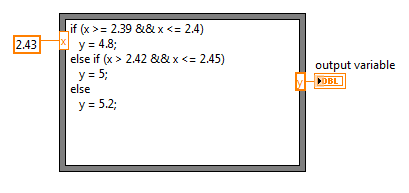

You could use a formula node from the Structures menu.  It uses expressions similar to C.
aputman
