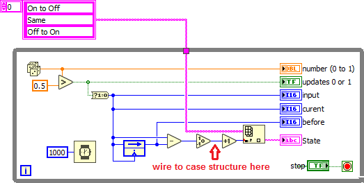

We already gave you plenty of abstracted simple answers. Please point out what's not clear to you. Here's what I would do:
Feedback node to get previous value.
Subtract old from new and wire result to sign function
Wire to case structure with three cases (-1,0,1).
One case for A, one for B, one empty for when nothing changed.
See how far you get.

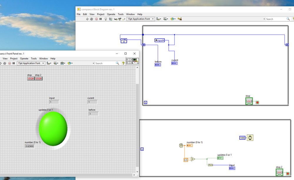

1. The "input" will give the 0 or 1 to the upper loop.
2. Now, I want to know how to see this before and current value. I don't know how to do this with feedback or shift register. right now, the current will be always the same as before. Could you please help me modify this vi, and load? Thank you.

Dear friends.
I need some help here. Thank you so much in advance. VI attached.
1. The "input" will give the 0 or 1 to the upper loop. In other words,  in top while loop, "input" will keep change between 0 or 1 for each iteration.
2. Now, I want to know how to see this "before" and "current" value in top while loop. I don't know how to do this with feedback or shift register. right now, the current will be always the same as before. Could you please help me modify this vi, and load?  Please do keep those 2 while loop.  Thank you.

One problem is that your upper loop runs millions of times per second, so the (current vs previous) reading will only be different for a nanosecond and you'll never see it. Your feedback node before the loop makes absolutely no sense at all. I really recommend you do a few more tutorials.
Here's what I would do (you can put it back in a separate loop, of course, but make sure to include a reasonable wait). As I said, if you need to execute different code parts depending on the state, wire to a case structure.
