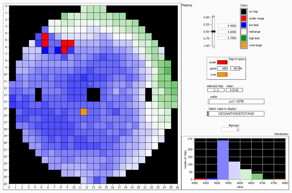

I might have a complete and running program for you:
I'm using an intensity graph to display the mapping data. You can set limits for each PROBER measurement, the program evaluates all measurements done for each chip on the wafer...

Hello Alex!
Thank you for your response!
Actually, using 2d intensity graph never come into my mind, as I'm not to familiar in using it.
I need to store values on each element such as store the results, the bins, etc.
My customer also request me that if the cursor hover on the wafer map, he wants the x,y corrdinates to be displayed.
He also wants to select some elements in the wafer map and come up with the coordinate values to do some testing.
I also have such a feature. Did you notice the little yellow cursor near the center of the wafer? One could easily change that to use a MouseMove event instead...
That's related to the cursor thing...

Hi Dennis,
this wafer map GerdW posted appears to me like some sort of histogram (e.g. http://www.ni.com/white-paper/4158/en#toc3);
altenbach posted this very well example which shows how to use an intensity plot to create a 2d histogram:
https://forums.ni.com/t5/LabVIEW/Overlay-plots-as-intensity-graph/m-p/211222#M119248
Learn how it works and try to adapt it to your specific task!
