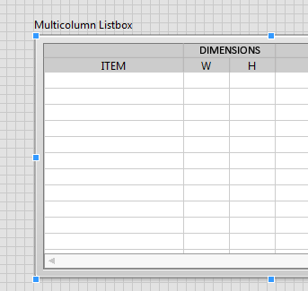

Hello, may i know Table or Multicolumn Listbox in Labview 2012 is available to change column header format such as below image?

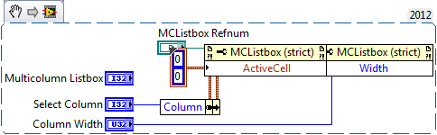

You can do something like that

Thanks Ben. But that is only change the width of column. I hope the column header can merge between second and third columns.

I don't think you can merge cells (like Excel) with a LabVIEW MCL Smiley Sad

You can put a free label on top of the 2 columns headers and make to background the same color as the header to imitate a merge cell.
