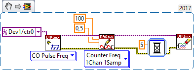

I'd say the normal solution is to use the Counter out and simpy set a frequency, then it's very easy to change speed. With your current solution you'll need to change the Wait(s).
/Y

As reference.
/Y

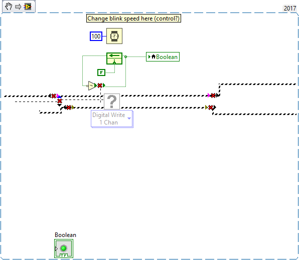

But I am using LINX in that there is no such option of counter frequency.

Then you basically have to change the case to this. Remove the for loop and have it perform the case every X ms.
/Y

Sorry I didn't understand.
Message 8 of 9
(3,854 Views)
Instead of having a For loop run 100 times, remove the for loop and let the whole program and Case run again and again, and switch the LED each time. The previous picture is the removed for loop with a feedback node for switching.
