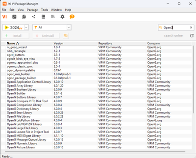

One quick thing you can do is search in vipm itself for OpenG and install.
-Or download file in this link and open with VIPM to install: http://forums.jki.net/topic/567-how-to-install-openg-vis-manually/

Ok, searching in VIPM worked.
I compared the installed openg-parts on the old pc and manually selected them on the new pc in vipm.

Use VIPM and search for OpenG:
Tim

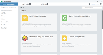

It looks like you can also install the open G libraries through the NI package manager.
Tim
GHSP
Message 6 of 8
(2,932 Views)
I tired the package manager and it did something, but what that something is I haven't figured out.  It appeared to install version 3 when the most recent version is 6.  I tried linking whatever it is that installed to the tools palette but couldn't find any means to do so.  The package manager knows that version 3 is installed, but LabVIEW doesn't. I did find a library of routines that can be used to work with gifs which is my immediate project.  I will post the library later.
