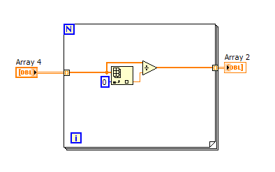

Index the 2D array to extract the first column. Use an auto-indexing for-loop to divide each row by the 1D array (column zero) that you just extracted.
See attached (LV 8.6)

sorry i wasn't clear with my question.  I do have a 1D array that contains 4 elements.  What I was trying to say in my previous post is how can I divide all succeeding iterations by the value of the first iteration (for all elements of the array)?
When I said
Array Element #1 = (2, 4, 6, 8 10) , i meant this as the value of the first 5 iterations having 2 as the resulting value of the first iteration. and I need to do the same operation for all 4 elements of my array.
I hope this helps!
(6,496 Views)
The trick is the save the first value.  Do this with a shift register in your loop.  When i=0, write the value to the shift register, when i not 0, divide by the shift register value.  See the snipit below.  Duplicate for every element, or convert it by adding more shift registers for all your elements.
