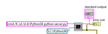

How to keep command prompt open and running python script
This gets me to the correct directory, but doesn't run the "python server.py" command.
The standard output is:
C:\Python34>
Showing the right directory, but doesn't run the python command. And with cmd /K, the command prompt won't stay open and I think it closes out of the server.py if it actually does start running it.
I try and run a client.vi after this, but it won't run unless my server is up. The client vi works if I manually open the command prompt and run the python server.
In case it's useful, the error out indicator shows the status as passing.
Thanks for the help!!
(4,891 Views)
You have D:\Python34 in your string constant rather than C:\Python34.  Is that the issue?
