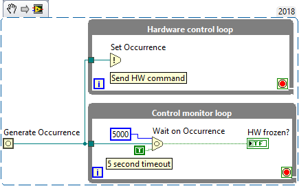

You could easily do this with a second parallel loop that "monitors" the hardware loop.  Then use occurrences, queues, or notifiers to monitor.

Great! Thank you so much! 🙂
