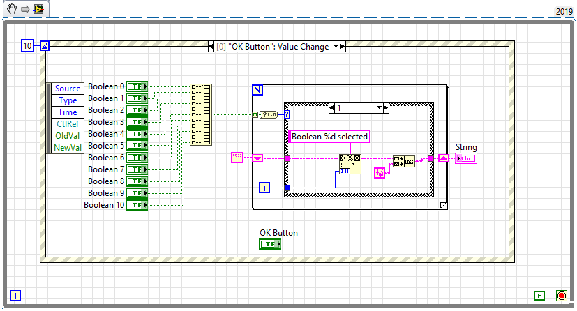

Interesting assignment... I would probably use a Boolean array for all of your controls. then you can watch the array for changes (OR Array Elements)  then search for the element that is a 1 and get it's Index and use that to select your text for the file.\
Something like this...

You could make an event in an event structure that includes all of the switches. Then when one is switched you can use the reference to get the control name.You can then have logic to add/subtract the control name from an array, which you can use to determine how many buttons are on. This array can be passed via a shift register, and when your write button is pressed you can read these control names and write them to the file.

Thanks for your idea! I did something very similar, using controls labels to create the string.
