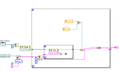

Here is an snip of the piece of logic. As you can see I am passing two data types to the select function. whichever matches the data type of the control being passed by the inner loop will make it through.
(1,536 Views)
There's no need for the Select. Both are Numeric refnums, it's just the graphical representation that differs.

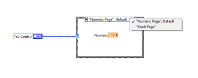

Solution 1:
Put your numeric control in a tab, and the knob in another tab. then with the tab you will now which one is selected.

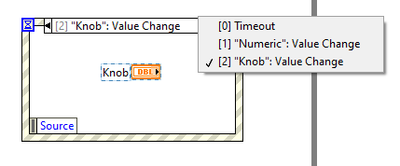

Solution 2:
Use an Event Structure. Modifying the numeric or the knob will trigger the right event.
