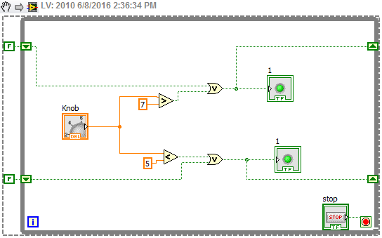

If I understand you correctly, all you need is a couple Shift Registers.  This will turn 1 high if the value exceeds 7, and it will not go low again until the program is restarted.  The same works for turning 2 low when the value goes below 5.
The way I understood it was that the >7 LED should turn off once the value goes <5. In your code is stays on permanently.
