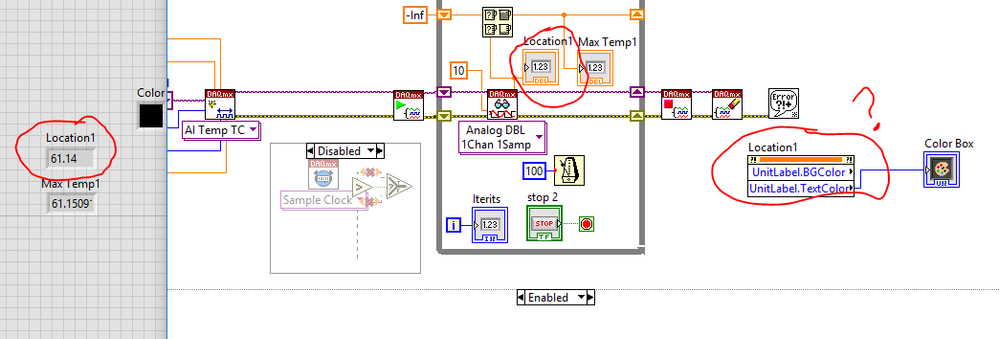

How can I make a color gradient based off of a value in an indicator box.
Say I want the BG color in the indicator box to go from a value 50 and be blue, then turn towards red as the value climbs to 200(200 being solid red).
I haven't managed to get any kind of color change so far. Don't know what I'm doing...

1. You are reading the property, so you will not be able to make a change. You need to write to it.
2. You need to do it in the loop otherwise it will just happen once.
3. You probably want to use the background color.

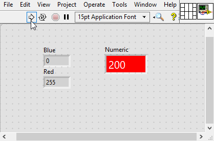

Can I convert that VI to 2014 somehow?
(4,576 Views)
Accepted by topic author LabNoob14
(4,573 Views)
Thanks! This will take me a little bit to figure out, but it helps a lot
