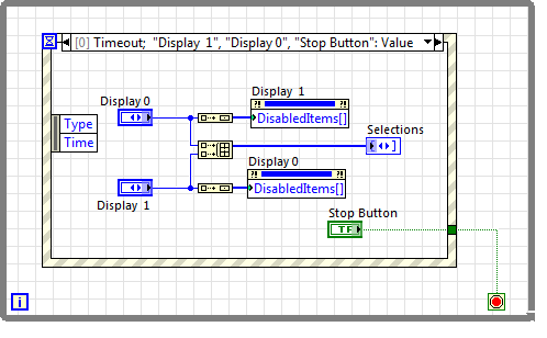

here is a simple demo using Enums and the disabled items property.  You can extend the approach to disable waveform 2 and set value to 0 and 1 when needed (Attached in 8.5) PNG from 2011 (not a snippet because of the p-nodes)

Always forget to downgrade
Edit: I vote for Jeff's idea... more simple. For some reason my mind read checkboxes as listbox.
Only use mine if you need a lot more graphs.

Very nifty, Jeff, and probably more intuitive for the end user than my initial checkbox idea too! Smiley Happy
