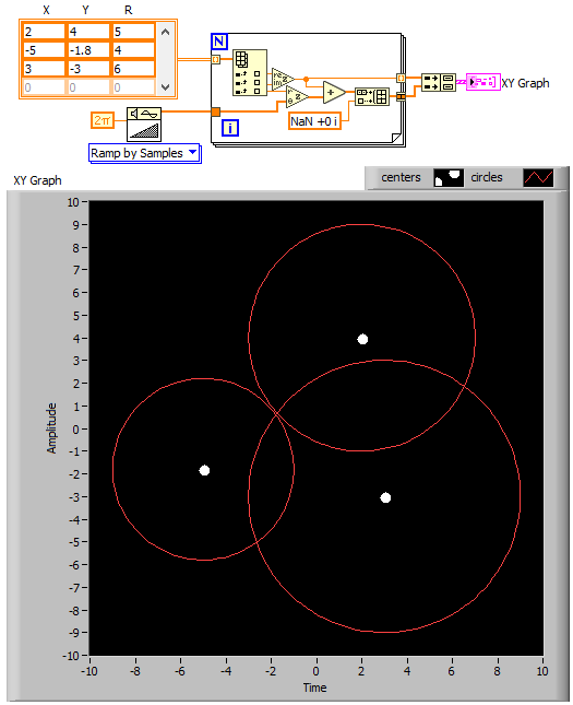

@altenbach wrote:
Ok, Do you just to draw a graph (easy!)
Here's some draft to get you started (image, no code to give you something to chew ;)) See if you can understand and implement it. (Almost) every part has meaning....
The diagram constant defines the circles, one per row [x(center), y(center), radius]

god bless you Smiley Happy, thanks you i will try to learn it then if i cannot understand the program you are giving i will ask again
