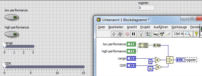

Hi Hussam,
it's all about simple bit stuffing:

Attach what you tried but did not succeed with.  It should be easy to recreate the VI shown in the picture.  If it didn't work, then you must have done something wrong and attaching your VI we can point out the error.
