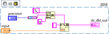

Old thread but still a intresting subject.
I want to get rid of the # in the format specifier. When I have 999.333 as stimuli and wants 2 sign. digits I get 1E10^3. It should be 1.0E^3.
Without the # I get the latter one.

Hi Shakti,
@Shakti211 wrote:
You forgot to attach your subVI. (It's not magically included in the snippet!)
What's the point of the empty string constant?
