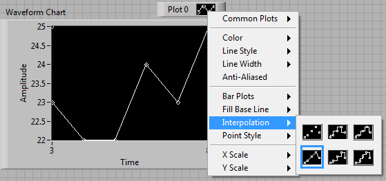

So i was searching searching the chart properties and i only saw the settings below that doesnt help much. I suggested to (picky) customer that hey maybe we can make the Y scale larger so the staircase lines wont look so obvious, the (picky) customer said no. So i was sweating about the tedious mathematics required for interpolation in the hot and noisy oil tanker without internet, luckily the evening bell rang.Smiley Wink

with your example values and the setting shown in the picture you should get a straight rising line Smiley Wink
Using the "straight line" interpolation instead of the "steppy" options should be ok!

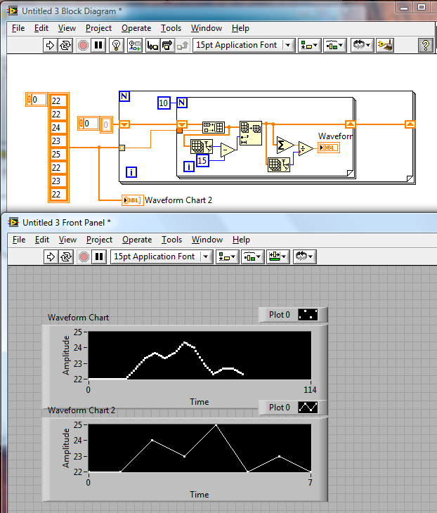

You could try oversampling by 10x and doing a running average of say 15 samples.
Here's an example of that:

Please show us an actual picture of the front panel showing the offending display. (Or even better, attach a simplified VI containing some real data. e.g. run the VI to see data on the graph, copy the graph to a new VI, make the graph data the default, save the new VI and attach it here)
