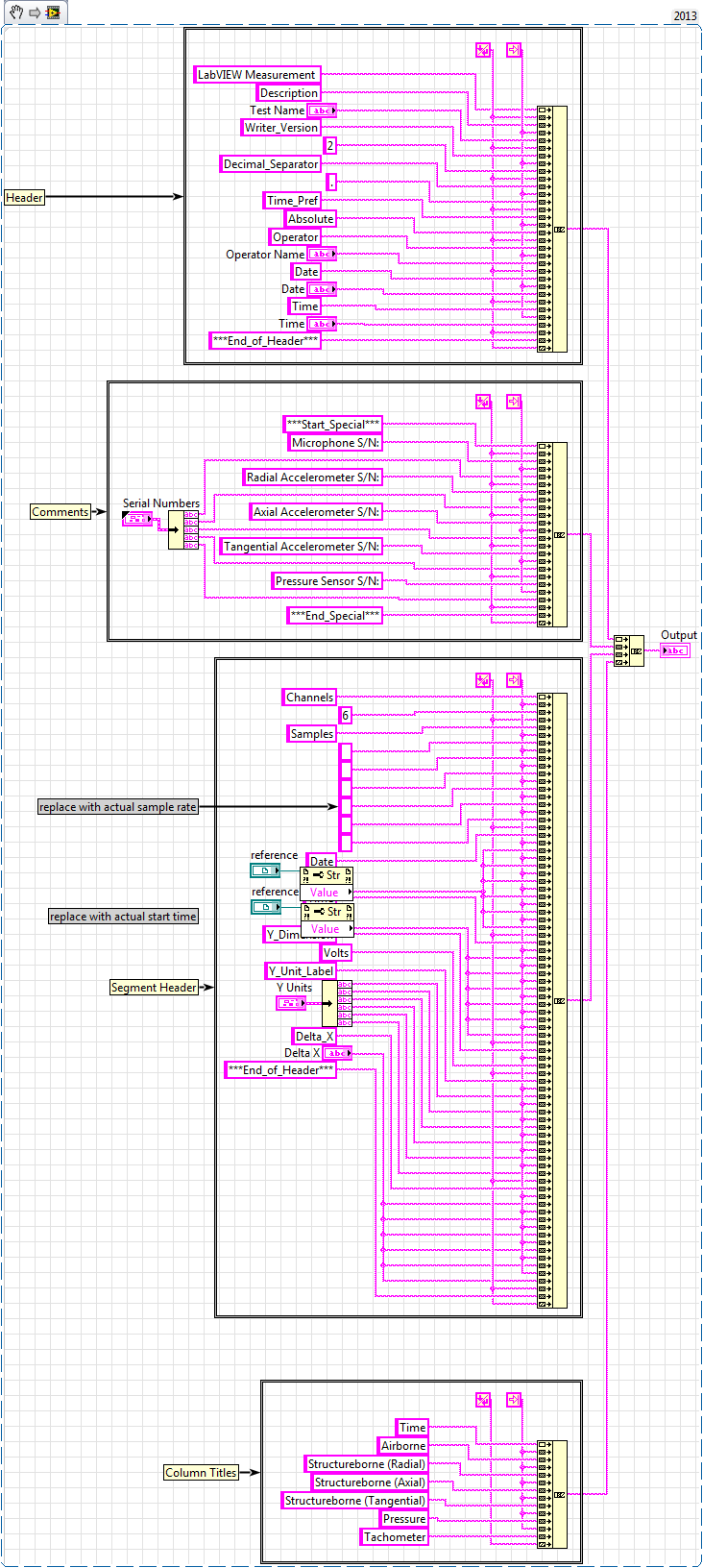

I tried producing the data using the attached subVI, which creates a single concatenated string, or by copying the data from a functional lvm file into a single string constant, and neither seem to work for me.
If there is a better way to do it, I would be very interested, my way is quite convoluted!

Hi CamW,
to create LVM files you should use the appropriate functions.
Creating the file "manually by concatenating strings" will fail without proper understanding of the file format!
Btw. all those big ConcatString functions can be replaced by FormatIntoString with some proper format string...

Hi GerdW,
Thanks for your help, could you give me an example of how I could format the string to save space?
I am not sure how to insert tabs or returns into the format string, and without that I don't see how I can simplify it.
Also, you say that the proper functions should be used, could you give an example of which functions you mean?

Hio CamW,
like this:

Hi GerdW,
Thanks for that, you would think that the backslash formatting codes would be listed on the FormatIntoString help page.
It turns out I had missed out the 'X0' line from the original header, as adding that, along with using FormatIntoString has fixed my problem and made my lvm files readable.

Hi Cam,
as the "\-Code" is a property of the string constant (and not the FormatIntoString function) you find the explanation in the help for the string constant
