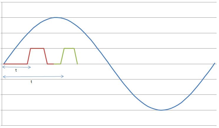

I have a 50Hz sine wave and a pulse signal on a same graph. The phase difference between two is between 0-90 degrees.
Now I need to calculate the time difference between (when the sine wave crosses zero volts) and (when the pulse rises). The frequency will stay approximately same for both signals.
The application is for a three phase generator. In simple words, when the time difference between the zero-crossing of sine wave and the pulse rises increases, that means that the load on the generator has increases.
I am a beginner user of LabView (version 9, 2009), maybe it is a very simple problem but I've been pulling my hair out for the last few days and coudln't figure anything out. Any help would be greatly appreciated. I am using DAQ USB-6008 to measure these voltages and pulse from the generator and a sensor
I have attached a jpg (a graph that i just made with excel to explain). The time 't' is what I am trying to measure

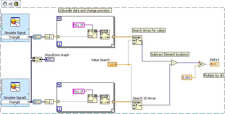

I am trying to do something similar but with different input signals. The signals come from two different transducers that will show a fast and significant change in pressure rather quickly. I would like to get the time difference 't' in between the two spikes.
can some slight modifications to the code posted do this for me?
thx
Message 6 of 11
(10,114 Views)
You can try searching your data arrays for a y-value.  I converted the precision to one decimal point for the comparision because the likelihood of both arrays having a value of 1.0000, for example, is slim.  If the value is not listed in either array, then the Search 1D Array function will return a -1.
Hopefully this helps!

Hi
Thanks for the code but I'm afraid it won't work. Like you said the probability of choosing a value that is on both graphs may not happen. This is something that I would like the code to do automatically.
But I did use the previous code posted and made some modifications to it and it seems to work perfectly. Now the next thing is to be able to get just that one value that tells you the first time difference.
