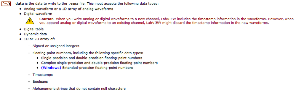

If you right-click the TDMS write function and select "Help", you will get more information on what kinds of data are acceptable. Waveform data is acceptable. You can use the "Build Waveform" function and modify t0 to have your timestamp before writing to file. This works just like a cluster, where you only modify the elements (t0) that you wish to change.

Thanks for that information! It's good to see what data TDMS can accept. I'm still slightly confused when you say "modify t0 to have your timestamp" I know the build waveform function, and the t0, but don't exactly follow what your saying.  Also, if you use a master cluster, do you need to unbundle everything and write them to TDMS separately? It seems TDMS can't accept a cluster?
