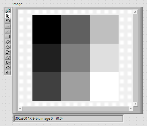

Maybe something like this will work for you. In the place marked "Load Images Here" you would load up your images from the file. Instead, I just create a ramp of values from 0 to 255. You might have to do some reorganizing to get the images exactly how you want them.

Thanks ...
