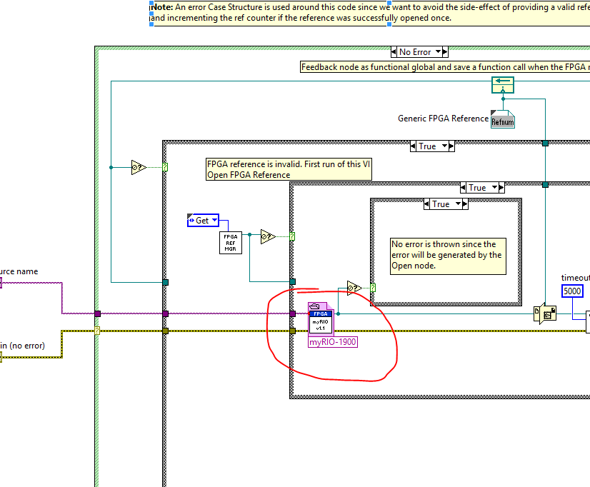

i removed all DIO pins from connector A and connector B except the PWM functions (see the attached file)
i built the bitfile then updated the Open FPGA VI Reference in myRIO v1.1 Open.vi like the solution said

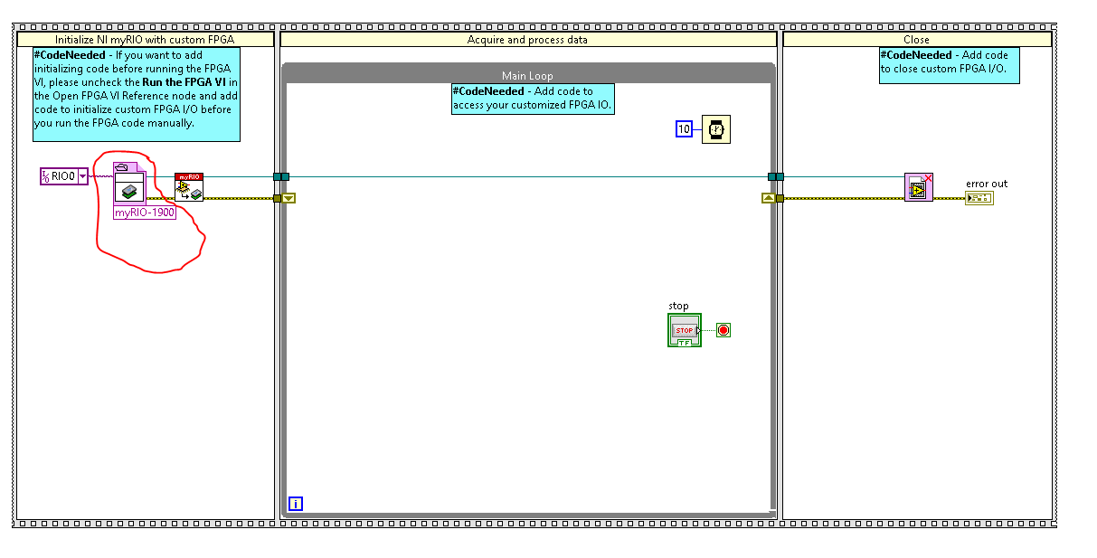

i also updated Open FPGA VI Reference  in my RT vi block diagram
after all that i didn't work  Smiley Mad
