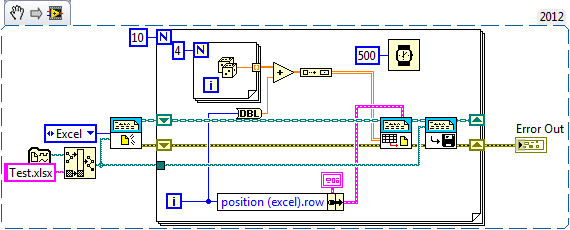

My thought was that the "Save Report to File" function was the equivalent of Ctrl-S, but I wasn't 100% sure, so I did an experiment (shown in the snippet).  I assumed we were going to be saving our data to a file called "Test.xlsx" that was originally empty (created by copying your Template and renaming the copy "Test.xlsx").  Every half-second, we generate 4 random numbers which we write as a single row to Excel, then do a Save Report to File.  To help identify which row is which, the random numbers have the row index added to them (so Row 1 is in (0, 1), Row 2 is in (1, 2), etc.).
Some notes.  I'm using Append Table to Report, which wants a 2D table, so I take my 1D row and do a Build Array which makes a 4x1 2D array.  I also want each row to be in the proper position, so I wire the index of the For loop into the "MS Office Parameters" input as the Row position for Excel.  Note that LabVIEW Index 0 is Excel Row 1.  If you are curious how I got the little icon at the top of the Bundle-by-Name function, I first did a Create Constant on the MS Office Parameter of the Append Table function (which returns a Cluster constant), then double-clicked the edge of the Cluster (a Magic Trick I learned several years ago).
You'll notice that I do not Dispose Report -- I'm simulating a "crash" in the LabVIEW program after only 10 out of 10,000 iterations.  What happens?  The Excel file stays open, you can "manually" close it.  Note that if the Save process takes too much time, you can simply eliminate it (or, much better, put it, and the Dispose Report, outside the For loop when it exits).  As long as Excel (or the entire PC) doesn't crash, you can again "manually" save (but remember to save!!) and close Excel.
So here's the snippet.  This should solve your problem (mark this as a solution if you agree).

Thanks so much for that! It got me really close to the solution. However, I just tried this set up to see if it would work. It goes through the first loop and then when it gets to the 2nd loop, it gives me this error coming out of the "save report to file.vi":
Error 5 occurred at Open/Create/Replace File in NI_Excel.lvclass:Save Report to File.vi->Power Cycle Test 3.0 Excel Save Testing.vi
Possible reason(s):
LabVIEW: File already open.
NI-488: Command requires GPIB Controller to be System Controller.
So it's not letting me save over the top of the already open and saved file. Does that make sense?

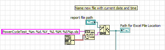

Agreed Even my previous suggestion was more convoluted than it needs to be.
This is the proper way to build your path.
