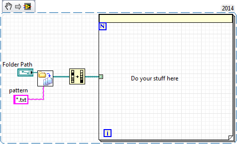

Are you just wanting to read all of the files within a folder then close them again after getting the data?
Just use the List Folder VI from the File IO pallette. You can input a pattern like "*.txt" to get all files of a certain type within that folder. Then fun that array of filenames into a For loop, Build Path with the original folder path, and Read from Spreadsheet.
Edit: Do what JeffP gave you. If you don't want the files within subfolders, do this:
Cheers

What different data types? The For loop is indexing through the array one by one, so you don't need to do an Array Index operation.
The snippet I included above should make it clear what to do once inside the For loop.

@CSmith8 wrote:
Thank you for a quick response.
How do you suggest i resolve the issue of different data types in order to use this function? I have tried a few different ways and have whenever I adjust, it wont run through my sub VI's correctly due to being different data types.
You have to READ THE FILES.  Jeff just showed you how to use a FOR loop to go through the files.  You still need to open the files, read them and then process the data.

Thank you, I missed though and thought that opening the files did that for me. I now have it working and running my files through while they are matching the ones I ran individually.

@crossrulz wrote:
I had assumed from CSmith8's original post that the text file processing vi worked.  just drop that vi into the for loop and wire the file name in!
