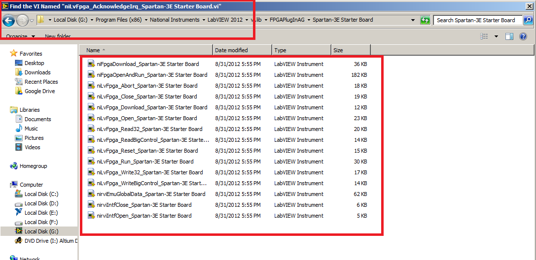

Hi
during work today I find that this file """nilvfpga_acknowledger_Spartan 32"""" is missed from  support files that AVAILABLE for spartan 3e
DOSE ANYONE HAVE IT!???!! please
regards

Can't help you there, unfortunately. You might start a new thread, since it is no longer on the topic of optimizing an FPGA VI. You may get more helpful responses in a new thread where the subject matches the question.
