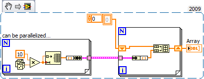

One possible workaround: When the arrays from your subVI differ in length you should put them in a cluster. So you can use autoindexing to build an array of cluster of array - with the disadvantage of needing another loop to concatenate the subArrays later on...

@Yamaeda wrote:
The current solution is a classic Concatenate arrays via shift register disallowing parallellization, but there should be some workaround, right?
If you use the concatenating tunnel, the second loop can be parallelized just fine. 😄

When the tunnel supports parallelization you could fulfill the task with just one loop (and without the bundle/unbundle step in between)!
