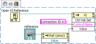

I am trying to pass a TCP connection ID into a subpanel VI, but wasn't successful.
Here's the function I used:
I was able to pass other control values into the VI but not the TCP conn ID.
Is there any restrictions or other ways I should do it?

Hi Ken,
Is 'reference' a TCP connection ID? If so, wire the reference directly to the Ctrl Val.Set invoke node. No value property of the reference needed.
It definitely works with TCP connection IDs.

Hi dan,
Thanks for the reply. Found out that I wasn't putting it in a loop, so the value didn't update.
