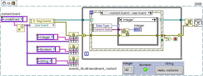

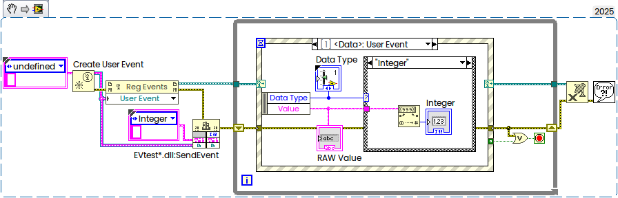

I can easily fire UserEvent from DLL something like that:
The code under the hood:

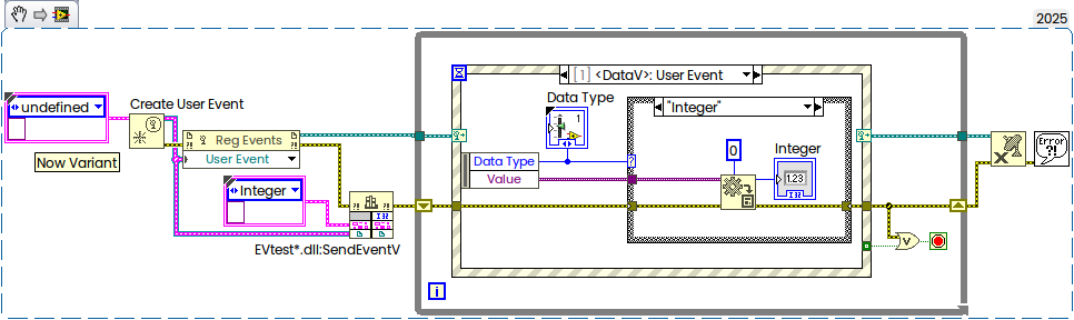

But such trivial serialization is not elegant. Now I would like to do the same, but with Variant:
The question is — how C Code may looks like?

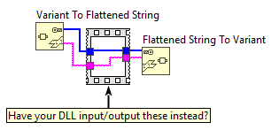

Anyway, how devoted are you to passing a Variant directly?  Or do you just want something that could be close?
I am wondering if the "Variant To Flattened String" and "Flattened String To Variant" are functions you would be willing to use in LabVIEW on either side of your DLL, because unlike the Variant itself, those formats are documented:
https://www.ni.com/docs/en-US/bundle/labview/page/flattened-data.html
Message 3 of 8

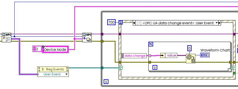

There is additional overhead, as Rolf mentioned above (thanks for the answer). If you take a look at the original NI Example for OPC UA client, you will see it:
The OPC UA data change event is set in the DLL (a reference is passed as a parameter to niopcua_client_createDataChangeSubscription(...) called from ni_opcua.dll). So, it is definitely possible, this is why I asked the question. This design has pros and cons, and many other solutions and workarounds to avoid variants are possible, for sure, from custom serialization to multiple events. I was just curious.
The OPC UA Toolkit uses a special form of Variant interface that is called FlexData or something along those lines. It is basically yet another flattened format that is most likely part of the original Logos framework that NI lifted from the Lookout software and for some part added to LabVIEW itself, probably related also to Datasockets and later Shared Network Variables, which are based on the same Logos infrastructure that Datasockets uses. I had investigated that interface too, and even started going down that path as I had not been able to identify a more direct access to the LabVIEW Variant with the existing APIs that LabVIEW itself exports. And going deeper into the manager core DLLs is simply an exercise that I want to avoid at pretty much any cost as that is for sure VERY LabVIEW version specific and not at all documented in any way by an inadvertent NI leak. I had managed to get it working for basic scalar datatypes but always felt unsatisfied by the fact that it is basically a multi step conversion (LabVIEW Variant<->FlexData flattened format<->whatever native binary format you want). By accident I then found an API that provided the missing link to go directly from LabVIEW Variant to native binary data, but it required to use the old 16-bit type descriptor. This is not ideal, but the advantage is that it is (almost) fully documented whereas the more direct 32-bit type descriptor and/or TDR class interface is simply so very much undocumented, that use of that is beyond what I was willing to put effort in.

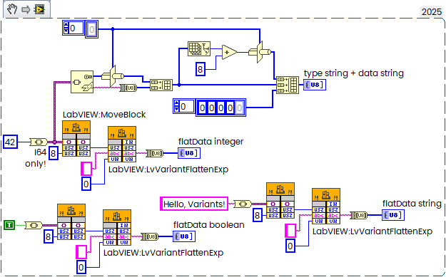

In theory, I can hook into internal variant structures, but this is not necessary because after some research, I've found a pair of functions:
MgErr LvVariantFlattenExp(const uintptr_t lvVar, LStrHandle *flatData, uint32_t lvVers);
MgErr LvVariantUnFlattenExp(const uintptr_t *lvVar, uint8_t *flatData, int32_t length, int32_t lvVers, int32_t lvContext);
They are exported but undocumented (as well as the whole Variant itself). In general, they're the same as 'Variant to Flattened String' and 'Flattened String to Variant', but suitable for DLL use. I only need the second one; it is sufficient for me.

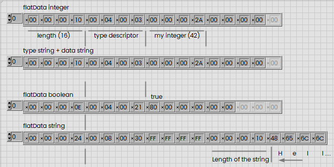

The 'flatData' parameter contains a sequence of bytes where type string and data string are joined together. The length should be written in the third parameter, and the last two can be zeroes (the 4th param is not fully clear to me, the last one is context, which needs to be investigated deeper).
Anyway, this flat data can be obtained with LvVariantFlattenExp(), just for better understanding:
And this is how it looks:
Type Descriptors are officially documented. For example, for Boolean and String:
and so on, refer to Type Descriptors.
Now I can do this in DLL. The only small thing — the sheer amount of C code I've written over the past 30 years is mind-boggling. I'm moving on, and now it's time for me to learn Rust:

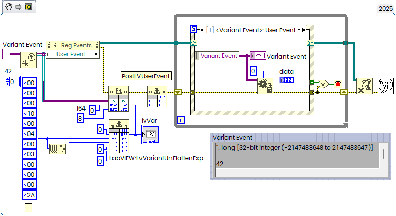

And here's how this is used and works:
I will leave it here; it may be useful for other participants.
If the code written in Rust is not clear for someone, I can illustrate with a pure LabVIEW code snippet:
Code is attached as LV2018. Disclaimer — use at your own risk, of course.
