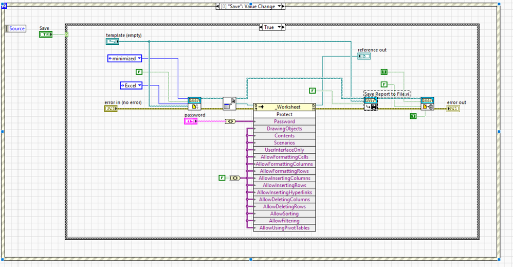

I tried with your solution with this:
No errors.. but no password is set ...
(878 Views)
Just a single worksheet in the workbook?
(872 Views)
