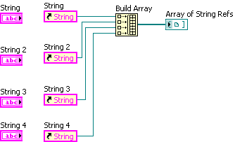

You can use the Build Array function in the Array functions palette to build an array of any data type on the block diagram. Here's an example:

There are two bundle functions for creating clusters. The function simply called Bundle operates almost exactly like the Build Array function I showed. The type of the output cluster depends on whatever you wire in as inputs. You don't have to supply a specific type parameter.
The function called Bundle by Name takes in a specific type of cluster in the top input and allows you to fill in the values of that specific type of cluster. To create the specific type of cluster you want, you need to create a cluster of string references. Here's how to do that:
  1. Go to the Front panel and drop down an empty cluster shell.
  2. Go to the Refnum palette and drop down a Generic Control Refnum. Now here's a cool trick to turn that generic refnum into a string-specific refnum (a so-called strictly-typed refnum). Grab a string from the controls palette and drag it into the Generic Control Refnum. Once you drop it, you'll see the refnum change its icon to display a string picture.
  3. Make copies of this string refnum (as many as you need) and add it to the cluster shell.
Now, if you're making specific types of clusters to work with, now is the absolute best time to learn about typedefs if you haven't already. It will save you hours and hours (if not days) of development time in the future. Trust me! 🙂
Jarrod S.
