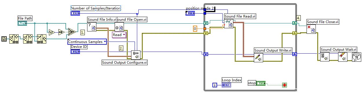

I'm working on a piano project, I'm using labview to play musical notes when a key is depressed.
I tried to use "Sound Output write", but it seems that this function is blocking, the sound card plays the next file only after the previous one ends. So if I depress many keys at the same time, sound files get stuck in sound card.
I also tried to use "Play sound files", it isn't blocking, but when I depree the key, there's a tiny delay before playing. Pianoists from music department don't like this delay.
I'm wondering is there anyway I could solve blocking/delay problems? Which function shall I use?

Hi Yatang,
It appears as though your code is trying to reference a file called "Note 12 Keys" and that this file is located on your desktop. Would you mind posting a link to this file so I can use it to try to better understand what might be causing this issue?

Welcome back, I thought this project sounded familiar: http://forums.ni.com/t5/LabVIEW/Can-quot-Play-Sound-Files-quot-plays-two-files-simultaneously/m-p/33...
Try wiring 0 into the timeout of the Sound Output Write.vi. That should cause it to begin playing and not block.

Hi Michael,
It seems that "Sound Output write" is still blocking even though I wire a 0 to timeout, it plays the sencond file only after the previous end.
