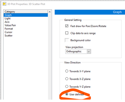

rotation is by left click and drag, zooming is b a ctl+leftclick and drag

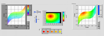

furthermore, there exist this trick:
http://forums.ni.com/t5/LabVIEW/How-to-display-4d-data-within-a-3d-scatter-plot/m-p/2508388#M763667
but I am quite sure, this is not what you want -
